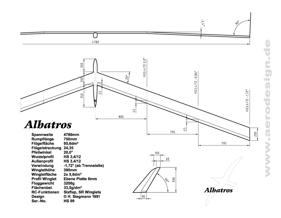

« Reply #27 on: May 29, 2011, 01:54:16 PM »
Offline bimmer
  • Posts: 361
    • You Tube channel
Re: FLYING WINGs
« Reply #28 on: May 29, 2011, 07:02:24 PM »
"Spannweite 4780mm"  auhhhhhh.......
mocno!
