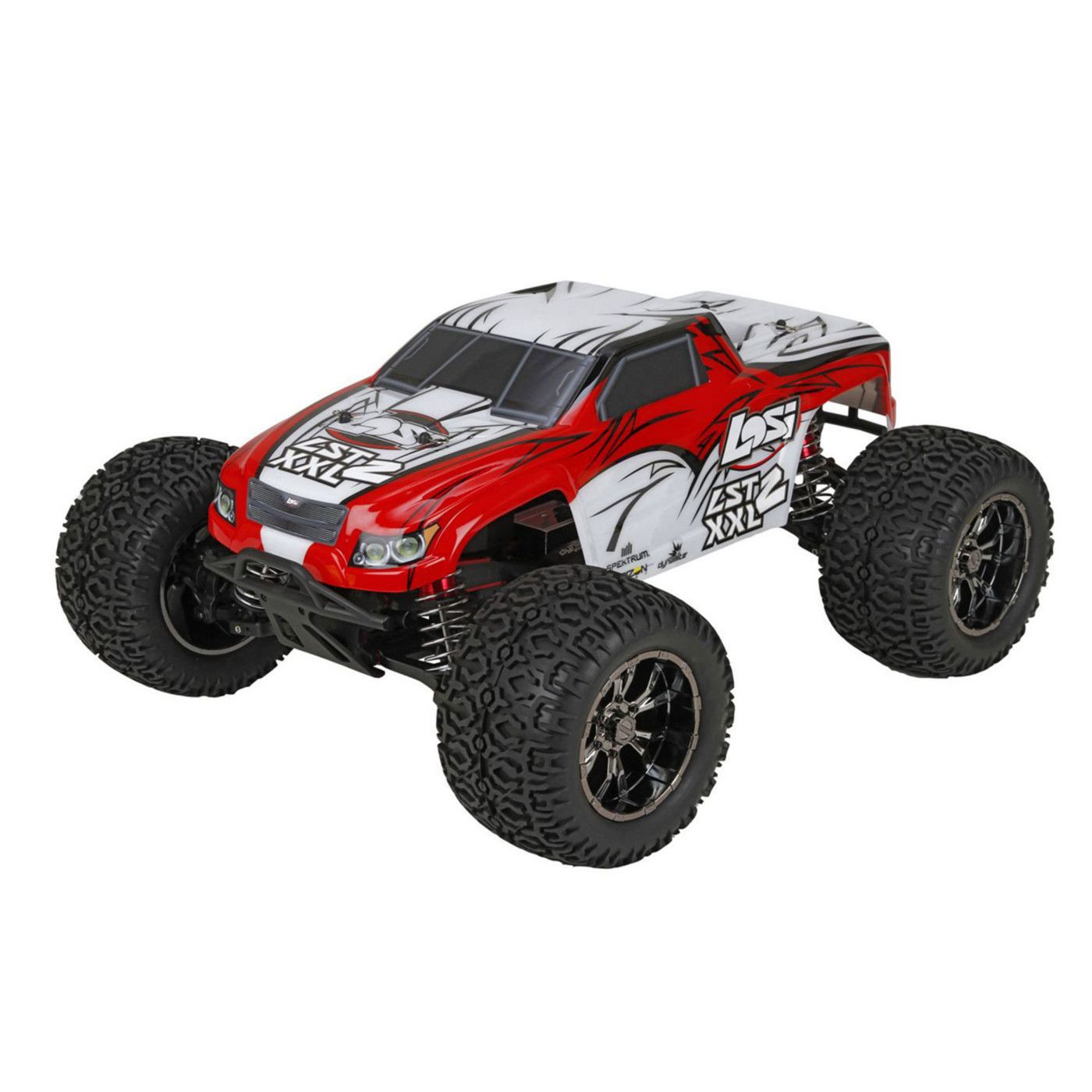

Prika… pa ne bih se bas slozio, ja sam ga imao u 2 navrata stari i novi (LST2 i XXL) i bili su odlicni i kidali .. ali oba u nitro verziji originalnoj..
ali evo je sad u Nurenbergu 3 verzija
LOSI LST XXL-V2  (Gas Engine)
Key Features
Innovative .31 cubic inch gasoline engine
AVC™ (Active Vehicle Control™) equipped
Full 4WD capabilities
Waterproof electronics
Extended length XXL chassis with red anodized chassis plates
Ultra-durable suspension and oversized shocks
Spektrum™ DX2E DSMR™ 2.4GHz radio system Included
Comes equipped with a convenient roto-start tool
http://www.losi.com/Products/Default.aspx?ProdID=LOS04002
